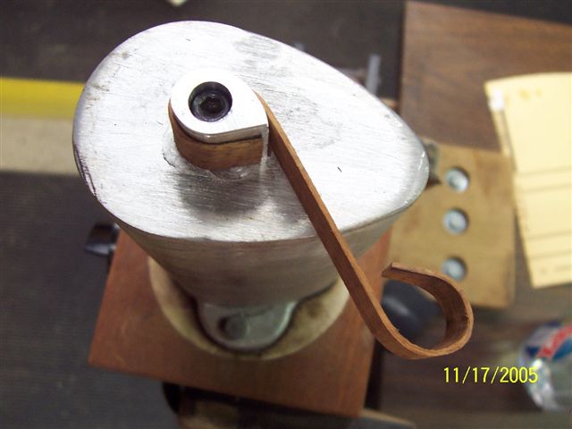

Did a little trial bending this evening with .050 Koa. Seemed to work well but did notice a little edge fracture when bending dry. (See scroll on the right.) A water spritzed bend worked okay.
I do need to make the mandrel slighly larger however as had zero springback. The piece was tight on the mandrel after bending.
Nelson

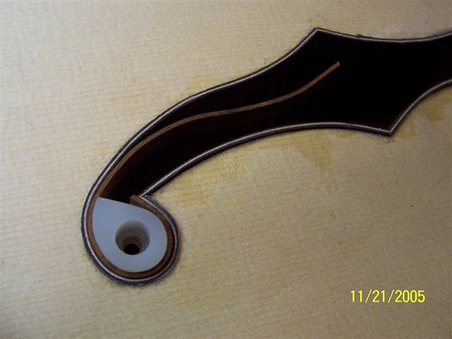

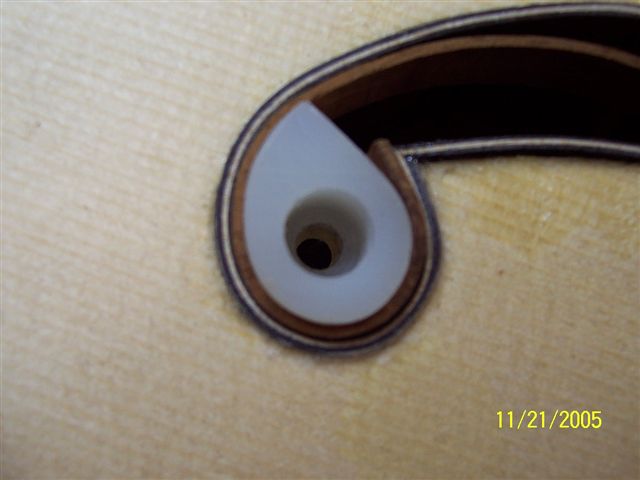

Also made a UHMW caul for holding the Koa in place when CA'ing in the F-hole. It's the same size as the aluminum bending caul mounted to the end of the iron as shown above. Discovered happily by accident that the caul will lock itself in place if turned c'clockwise as shown in the photo. That feature should come in handy when doing plastic bindings also as it's always tough to get a nice fitup all around the inside of the F-hole.
Made a set of these for the purfling also. (CNC, of course)
Anthony--I found that a temp of 170C/340F works good for bending the Koa without scorching it.
Nelson

That's pretty slick Nelson. The koa looks nice against the b/w/b purfling! I trust the purfling is made of wood....

PostPosted: Wed Nov 23, 2005 6:14 am
Posts: 2997
Nelson,
That looks really good!
You can tell the difference between wood and plastic purfs. Plastic and the fiber stuff not so much difference. Both the plastic and fiber are a lot whiter than maple purflings and if you start intermixing them you can tell.
I really like your little clamping cam,it is a clamp right?
PostPosted: Wed Nov 23, 2005 8:07 am
Posts: 1534
First name: Nelson
Last Name: Palen
Jim
Clamping Cam is a good name but it didn't start out that way. Discovered by fiddling that twisting it would not only cam the binding against the wood but it also locks in position. Had initially planned to drill and tap 1/8NPT-27 tapered pipe thread, split the UHMW nearly in half and then spread it for clamping with an 1/8" pipe plug.   Used UHMW so that CA spillover wouldn't bond.
